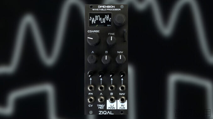

Dimension is a new wavetable oscillator (10HP) for Eurorack. Unlike the other releases, Dimension is a 24-voice polyphonic stereo wavetable oscillator. That sounds like something new.
The engine uses 2048 samples x 256 waveforms wavetables, can store up to 25 wavetables internally and is compatible with xfer Serum Synthesizer wavetable files. If necessary, you can easily import new ones onto a microSD card and scroll through them via a fast visual file browser.
Polyphony & 2 Unique Operating Modes
Polyphony and the possibility of working in stereo is particularly exciting here. Dimension is capable of playing up to 24 voices simultaneously within 10HP with the option to work with chords and unison.
The module has two different modes to explore: classic mode provides 4 oscillator voices paned over the stereo outputs while Dimension activates a waveform morphing function with up to 6400 different waveforms. There is an internal note scaler and function inside the classic mode giving you the option to create chords with up to 4 voices. Alternatively, you route MIDI in the module via the dedicated MIDI input. Two different modes with which you can achieve very different results
Further, you have two output modes. In dual mode, the module outputs two different wavetables on each output while in LFO mode, you get the same output but with a subsonic frequency range.
Plus, you get an option in any mode to multiply the voices 6 times with detuning to play them in 6-voice unison. With 4 voices, you can smash out a total of 24 voices out of the new wavetable module from ZIQAL.
An exciting wavetable module. Polyphony, stereo and wavetables at just 10HP is impressive. The module does not go as deep into wavetable manipulation as the Osiris, but has other points that can convince many users.
