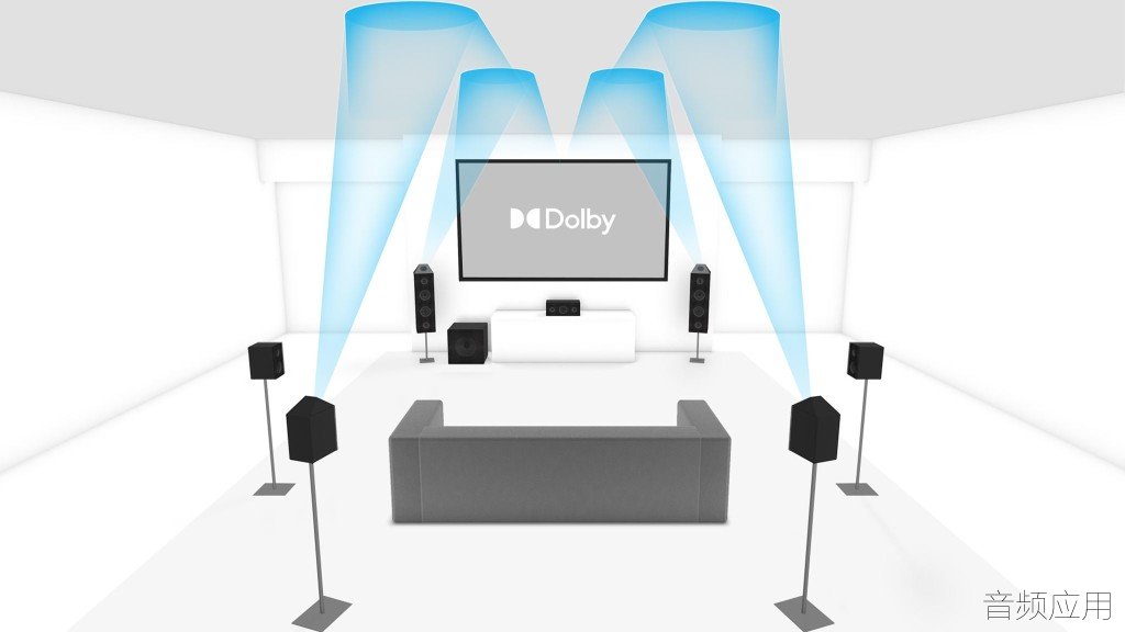

Yeah. Dolby describes what 7.1.4 is and how to set it up here:
7.1.4 Overhead speaker setup
Those instructions are for consumers, but they¡¯ll tell you if you¡¯re preparing game audio in Atmos to do the same thing. And if you¡¯re mixing on a job, you probably want to get this right so you can, like, charge more for doing it properly. It¡¯s also clearly going to important for schools and rented studios to put together this rig, so the rest of us can do our composing and sound design in our bedroom or some ratty basement somewhere, but then finish the mixes on the right setup.
This is how Dolby hopes folks will remake their living room. (Hey, works for me. Actually ¨C I don¡¯t really even need other furniture; I¡¯m happy with a couch and speakers and a big panel; just add a desk to turn this into a studio and I¡¯m good.

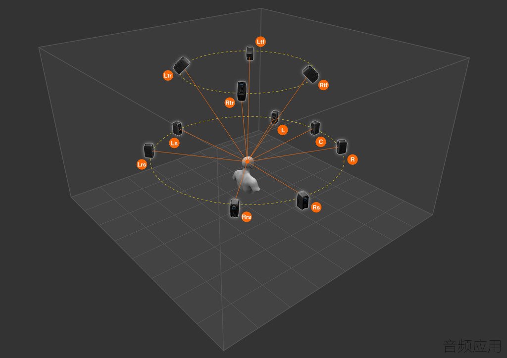

¡­ and here¡¯s IK¡¯s visualization of that channel configuration.
7.1.4 is actually not all that exotic if you¡¯re familiar with past surround formats ¨C which is the point; Dolby had to sell this to folks used to those formats. So you start with left and right ¨C there¡¯s your stereo ¨C plus center. (Center channels go back to the very beginning of cinema with synced sound.) Then you add left and right rear. (That¡¯s what quad added, too.) What separates cinema listening from music listening is really the standardization of middle speakers ¨C if you¡¯re daring to go to movie theaters in this pandemic, take a look over your shoulder on either side and you¡¯ll probably spot them. That helps a lot with feeling like there¡¯s a lot of sound. (Not incidentally, sticking speakers all over the place was a big part of what allowed Disney¡¯s cinema engineers to make Fantasia feel like it was actually flooding the crowd, figuratively and literally.)
All of this gives you pretty decent spatialization, but not height ¨C and your ears and brain are really good at perceiving height, presumably an evolutionary advantage to someone hurling rocks at us or avoiding getting hit by a falling tree branch or¡­ sorry, I¡¯m a musicologist, not an evolutionary biologist.
Height in 7.1.4 comes from adding overhead speakers, and that¡¯s where the extra speakers come from.

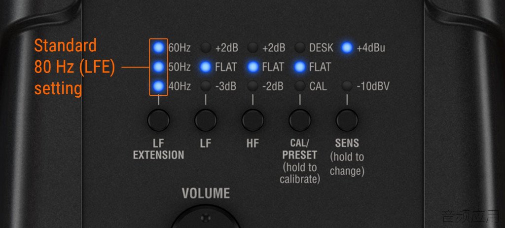

The iLouds weren¡¯t quite there yet for use in a proper Atmos system, though ¨C and that got addressed this week with a firmware tweak for the iLoud MTM studio monitor, shipped as 1.2.0.
It¡¯s a big deal, but it¡¯s a small change ¨C they added an 80Hz low-frequency cutoff which you need for Atmos setups. (That¡¯s relevant to other competing cinema standards, too, since they also use a separate sub channel ¨C in the theater, that¡¯s what¡¯s under your seats. 60, 50, and 40 Hz were already there, so adding 80 means support for all currently in-use cinema/spatial formats that I know of.)
If you¡¯re on IK¡¯s mailing list, you¡¯ve seen the marketing for this, but it really just comes down to that software feature. Everything else is just fundamentally advantageous in the iLoud MTM design. (The same is true of some other smaller speakers, but the iLoud studio monitors have the advantage of being in their own price/quality class.)

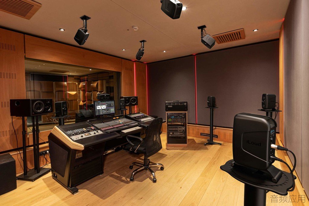

iLoud MTM pair and ARC mic. (You can buy them individually. Note the flexible routing on the back ¨C that¡¯s part of what makes it worth upgrading from iLoud Micro Monitor to MTM.)
Here¡¯s what this looks like in an Atmos-ready studio ¨C and it really does cost significantly less and involves less cumbersome speakers than other Atmos studios I¡¯ve seen, including those touted by Dolby.
