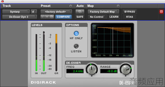

6. Pro Tools Dyn3 De-Esser
Sometimes, this thing just works. The bland, gray user interface and lack of fancy controls don¡¯t really deter me from using the Dyn3 when it sounds right. Of the crop of de-essers that came out before plugins started to get really flexible and impressive, I¡¯d choose the Dyn3 as my go-to.
Mix Tip
Use the ¡°HF ONLY¡± feature to apply de-essing to frequencies above a certain frequency. I¡¯ve found that the resulting sound (at least on this plugin) is far more natural and transparent.
