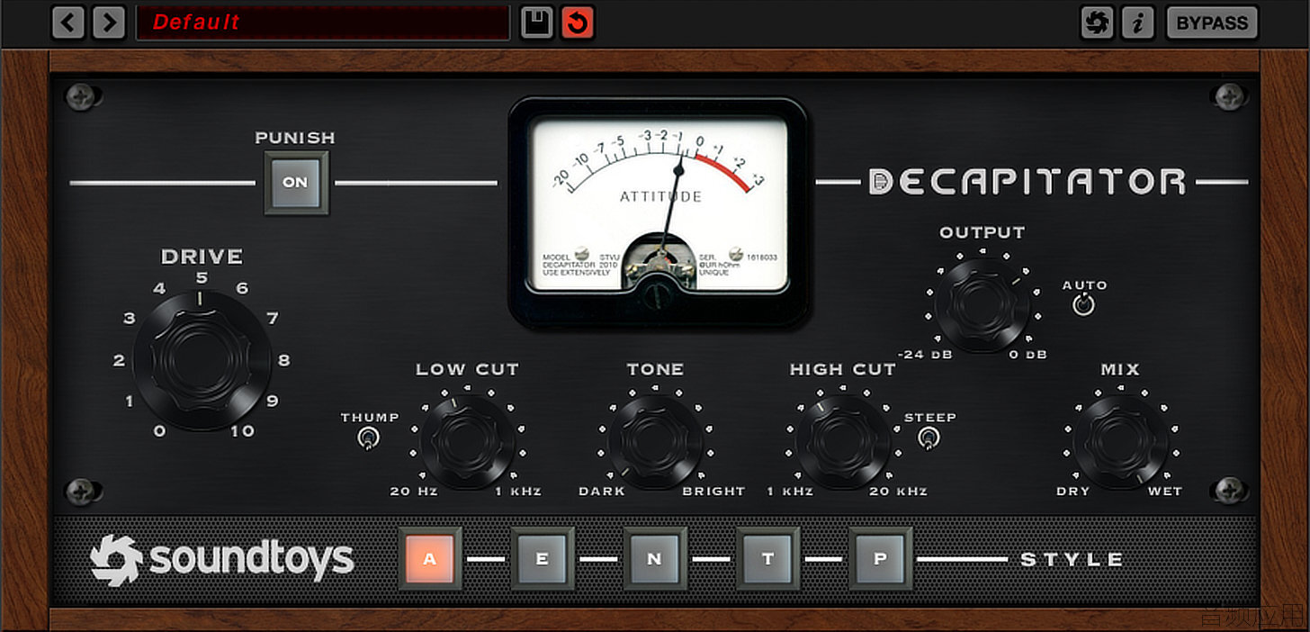

Screamed vocals will pretty much always benefit from some extra saturation or distortion to get them sounding really BR00TAL. My personal favorite tool for this purpose is an amazing plugin by Soundtoys. Try using the Decapitator plugin on the EMI setting ¡ª but pretty much any saturation unit will do the trick, including hard-pushed tape emulators and even guitar amp simulators if you¡¯re feeling extra creative! Experiment with using your distortion directly on the channel or in a parallel configuration for added control and flexibility.

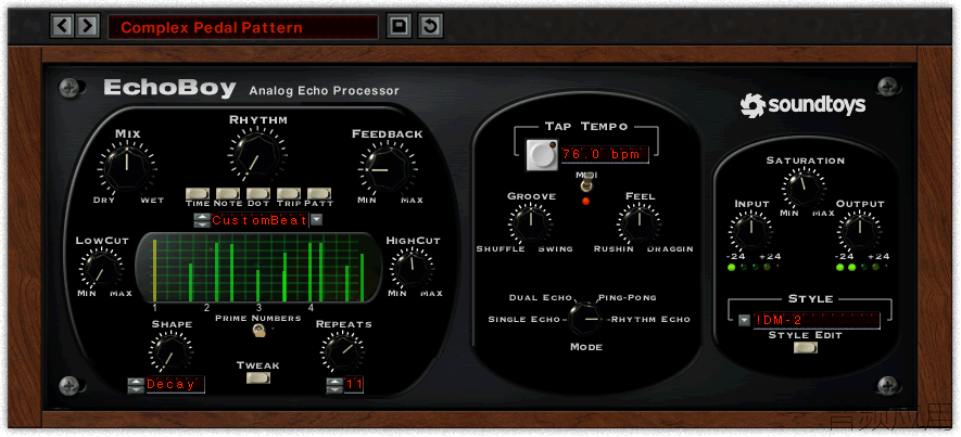

11. Reverb in Metal?
A lot of engineers, myself included, tend to favor delays over reverb for ambience and space when mixing vocals in a heavy context. Generally speaking, when you¡¯re dealing with a super-dense, heavily distorted arrangement, as is typical in the genre, reverb often simply can¡¯t cut through all of the noise as you¡¯d hope it would, and will mostly just contribute noise and mud into the equation.
Delays on the other hand, if treated and set up in the right way, can give the same illusion of depth while still remaining audible ¡ª all while taking up a lot less space in the overall frequency spectrum. It¡¯s simple: dial in your delay (or delays) as you typically would, but heavily filter out the lows below 500-600 Hz and highs above 5-6 kHz. This ¡°diet plan¡± alone will allow you to push them much louder in the mix without getting in the way of anything else.
To take this even a step further, saturate/distort the delay return, either via the built-in options available in your delay plugin of choice or via an external distortion plugin. Personally, I find that either of the ¡°studio tape¡± and ¡°telephone¡± distortion characteristics within the Soundtoys Echoboy delay plugin are fantastic options for this purpose depending on how blatant of an effect I¡¯m after. Saturating/distorting a delay has the effect of channeling it further into the midrange as well as somewhat compressing it ¡ª both are results that will allow for better separation and audibility within a full mix.
