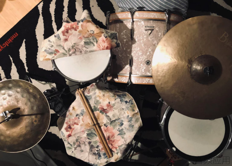

4. Use the Room, and Understand Its Limitations
Fact: the room you record drums in ¡ª and the kit¡¯s placement within the room ¡ª can dramatically affect the final product.
This can be a frustrating revelation if you¡¯re recording drums in a bedroom or small practice space. That said, having a less-than-ideal recording environment doesn¡¯t mean you have to give up hope. Whatever your room looks like, putting the kit in different spots is going to result in different types of sounds.
ADVERTISEMENT
There¡¯s no way for me to know what your room sounds like, but some basic concepts most likely apply: the dead center of the room is typically best avoided as a place to put a drum kit, and so is a spot too close to a wall. Corners can be good for ¡°focusing¡± the sound of a drum kit, but be careful for reflections from side walls. Placing the drums along a longer wall, with nothing close on the sides, will give a more open and spacious sound. If your room sounds too live, gobos and baffles can be used to make the kit sound tighter and more intimate.
Small spaces are not going to be particularly friendly to room mics ¡ª look into room-modeling reverb plugins as an alternative. Low ceilings tend to create problems as well. In short rooms, try ¡°underhead¡± and front-of-kit placements as an alternative to traditional overheads ¡ª they can yield quirky-but-usable results.
