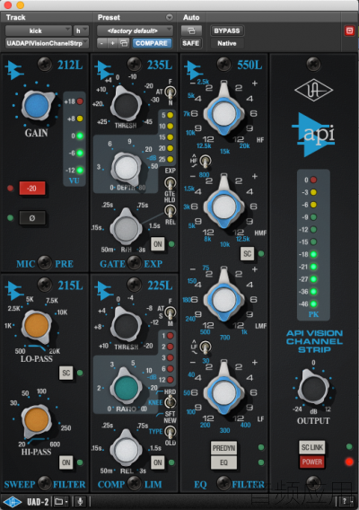

UAD¡¯s API Vision is a personal favorite for drums
Even when mic selection is limited, preamp choice has a ton of potential to color sound sources almost as dramatically as mic choice can. I realize that it¡¯s probably unrealistic to assume that a studio or home setup with only one mic would have multiple preamps, but there are some truly great preamp emulations available as plugins.
While applying a preamp emulation as an insert effect may not be enough to capture, say, the transient response of an API console, the harmonic characteristics of different preamps or channel strips still shine through in many emulations.
For best results, don¡¯t be shy about driving those ¡°pres¡± a bit. Preamps best show their sonic colors when they see a healthy signal. Though audibly distorting every track in a mix is probably not going to work out well, choosing certain tracks to imbue with extra vibe from a modeled piece of vintage gear is a great way to emphasize them and make them pop.
