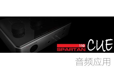

SPARTAN CUE 110ÒôƵ½Ó¿Ú
²úÆ·¼ò½é
110dBA Dynamic RangeMore than 3 times quieter, 2 times lower distortionMaximum Dynamics in Real Worl...
