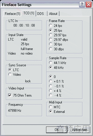

All settings can be accessed conveniently from an additional page in the settings dialog of the Fireface 800.
The clear and easy dialog site appears automatically after a TCO is installed. On the main page the new sync-option TCO can be selected.
The dialog provides all important options: Sync-Source (LTC, Video or Word Clock), termination for BNC input (75 Ohm), Frame Rate of the incoming SMPTE signals and WCK Conversion.
Furthermore the TCO dialog shows Pull-Up- and Pull-Down-factors and state information (Input State) about the incoming signal. E.g. an incoming word clock signal is analyzed and displayed to be in the Single Speed, Double Speed or Quad Speed range.
Settings Dialog
