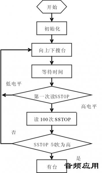

  搜台前,必须先对TDA7540寄存器进行初始化,FM搜索电台的初始化为:TunerReg[14] = 0x25;TunerReg[5] = 0x1B;TunerReg[6] = 0xAF;TunerReg[18] = 0xB4;TunerReg[19] = 0xCF;TunerReg[30] &=0x7F;TunerReg[31] &= 0x7F;搜台流程如图3所示。
  图3 搜台流程图
