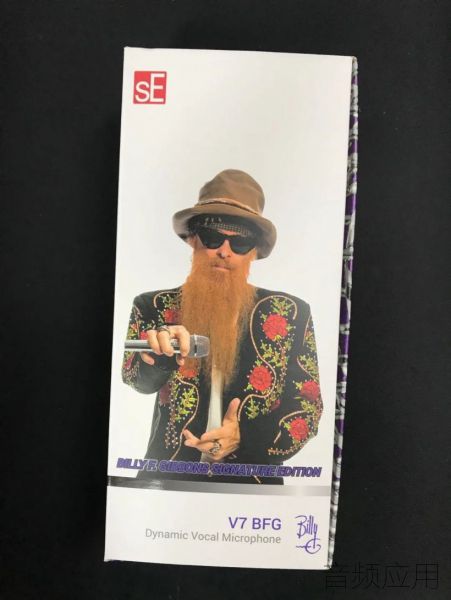

sE V7 BFG 话筒的评测$ d% N# q  a# V- H3 ]2 T* w% J" Q* Y
. D8 L% U  G! Q! d6 [, f9 N% f9 n: [" m
嘘!这是一篇严肃小总结1 L* \5 |8 ]- l' z$ O& \' d7 x
  f! \9 U, E7 M+ {# u. A
sE V7 BFG
" r) O. G5 m! Q0 C: M
