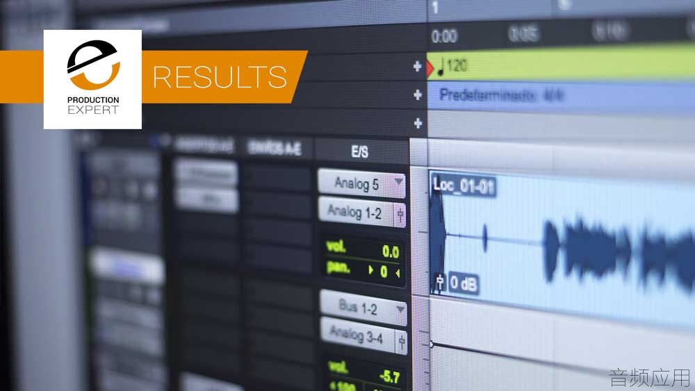

So Why Aren¡¯t More People Using Higher Sample Rates?
In our 2019 poll of nearly 2,000 professionals and hobbyists recording and mixing audio, only 1 in 5 said they bothered recording and mixing above 44.1kHz/48kHz. Two groups were polled, those who said they were professionals and those who said they recorded and mixed as a hobby, in both cases, the majority opted to record at either 44.1kHz or 48kHz.
