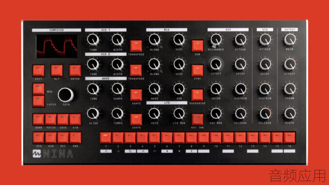

NINA is a new 12-voice multi-timbral polyphonic Synthesizer with layer, split and overlapping options. It combines analog and digital synthesis with a motorized recallable and automatable control panel. That¡¯s the real highlight here. A Synthesizer with motorized knobs is innovative but also fascinating to look at.
The motorized pots enable visual feedback of the actual patch on a hardware device that is otherwise only possible with software synths. So the patch change is reflected not only in the sound but also in the interface.
Melbourne Instruments goes even further by embedding this motorization in the modulation, which also gives direct feedback from the active modulations. That¡¯s also super novel. The developers use long-lasting zero-wear encoders with the feel and precision of analog pots. I¡¯m very curious if they really last that long, as these are not just simple pots but motors. A mechanical element that can break.
NINA, Analog Meets Digital
NINA¡¯s engine features three oscillators combining analog and digital synthesis. It features a single analog triangle oscillator with a width knob allowing you to continuously morph it between triangle and sawtooth. According to the developers, it¡¯s different than a traditional blend functionality. It also has an FPGA digital oscillator, a classic wavetable oscillator, and a noise source. There is also a sampling capability but nothing concrete has been communicated about this yet.
Then, you get a 4-pole transistor ladder VCF with modulatable resonance and a filter overdrive with massive voice level says the developers. Modulation side, you get two front panel ADSR envelopes, one for the filter and one for the VCA. LFOs are also included but no further information about the feature set. All of this is managed via a deep modulation matrix that is supported by the motorized knobs. This makes patching very straightforward and quick edits can be done in seconds.
NAMM 2022 Melbourne Instruments NINA
The engine also includes onboard effects and four DCAs enabling stereo infinite panning effects. The motorized knobs also make smooth patch morphing possible, which allows you to create very expressive sounds.
A Raspberry Pi 4 controls the digital part of the engine that is powered by open-source, hackable software. According to the developer, you can use them to develop other synthesizers or to add new functions.
Connectivity
Connection side, you get 4 assignable combo audio + CV inputs and 4 assignable line outputs. One of the inputs also supports a microphone signal. A headphone output is also onboard.
It also features a USB host functionality allowing you to connect class-compliant USB-MIDI controllers directly. Further, you have a classic USB MIDI input that transmits both MIDI and audio to your DAW. So you get full MIDI integration, automation, and an audio interface with the same cable.
There is also a MIDI interface with DIN MIDI input, output, and thru sockets. This section is definitely rich in features, nice.
