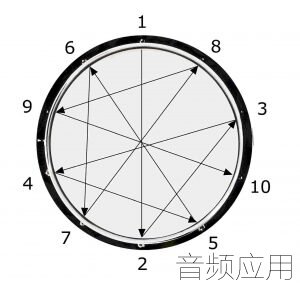

The goal of drum tuning is consistent tension across the entire head. Tightening the lugs around each head evenly (usually bouncing between them in a star pattern, rather than moving in a circle around to each one) will result in a consistent tone that can ¡°sing¡± more clearly. The relationships between batter and resonant (top and bottom) heads will absolutely affect the sound of the drum being tuned, and there are different schools of thought about what combinations work best.
If you record drums often and are not a drummer yourself, you might consider investing in a drum tuner. Hearing the difference in tuning around each lug can be tricky, especially if it¡¯s not something you practice all the time.

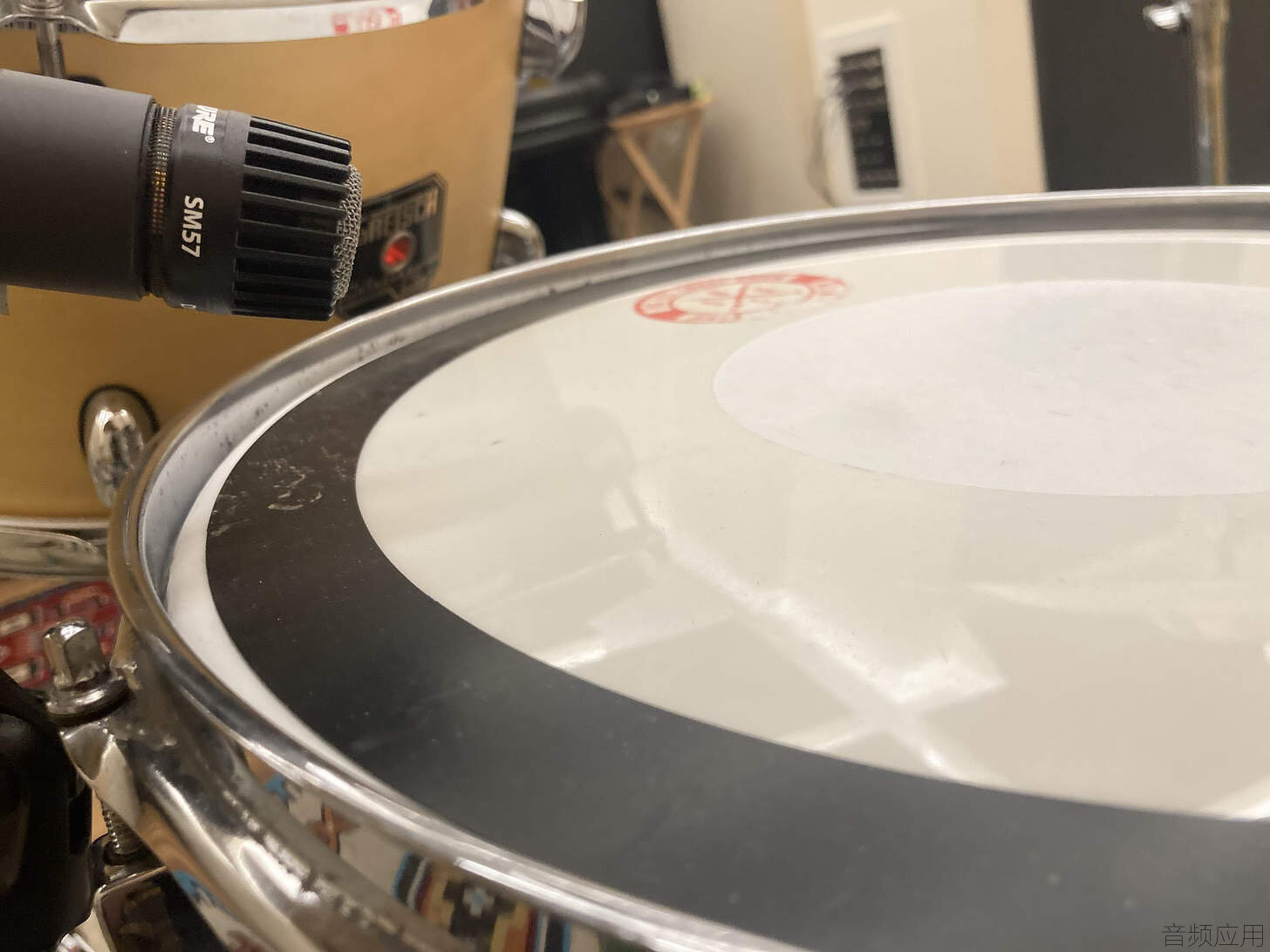

It can be tempting to think of, say, a snare mic as the basis of your snare sound. And to a degree it might be, but try this: solo your overheads and listen to the snare. Now solo the snare mic. Which one actually sounds like a snare drum? The snare close mic likely sounds kind of weird out of context, while the overhead(s) probably sound much more natural.
That said, close mics are crucial to getting a drum recording that hits hard and gives you flexibility during mixing. They help capture the snap of the sticks on the head and real low end & low midrange meat. They will also give you more precision in your stereo image when panned properly, and they¡¯ll give you the ability to ¡°turn up¡± individual drums in the mix.
Close mic placements might include both top and bottom mics for snare and toms (point the top mic where the stick hits the head) and inside and outside kick mics. Find the combination that does the most to reinforce your overall drum sound.
