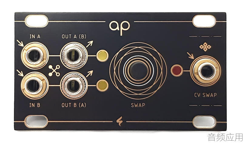

ST-Modular CV Gate Swap & Switch
The second new ST-Modular DIY module release is a 1U CV gate utility module. It is called CV Gate Swap & Switch and can be used to switch signals on and off or swap them between two destinations.
When a gate signal is applied to the GATE input IN B is connected to OUT A and IN A is connected to OUT B. When the gate signal is low, IN A goes to OUT A and IN B is connected to OUT B. You can also switch the signal manually using the latching switch in the middle of the module.
If nothing is connected to IN A, +5V are provided at the active output socket.
This way you can use AP as a manual gate or as an alternating gate trigger for two targets.
